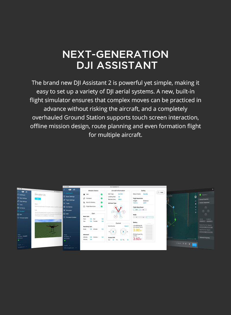

- Precise Configuration with DJI Assistant 2
