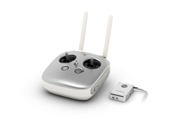

In what ways has the DJI Lightbridge 2 been enhanced since the previous version?
The following enhancements have been made to the DJI Lightbridge 2:
A new SDI output port has been added. The Remote Controller function is integrated with the Ground System, so that you don’t need to buy an additional Remote Controller. Transmission latency has been reduced to as low as 50ms. Transmission range has been extended to up to 5km. Intelligent, adaptive wireless technology has been added for increased transmission reliability. Picture-in-Picture output support has been added.

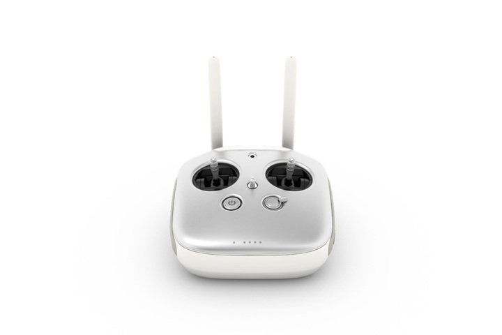

Can I use the DJI Lightbridge 2 together with Remote Controllers from other brands?
No, the Remote Controller function is integrated with the Ground System. There is no need to buy extra Remote Controllers.

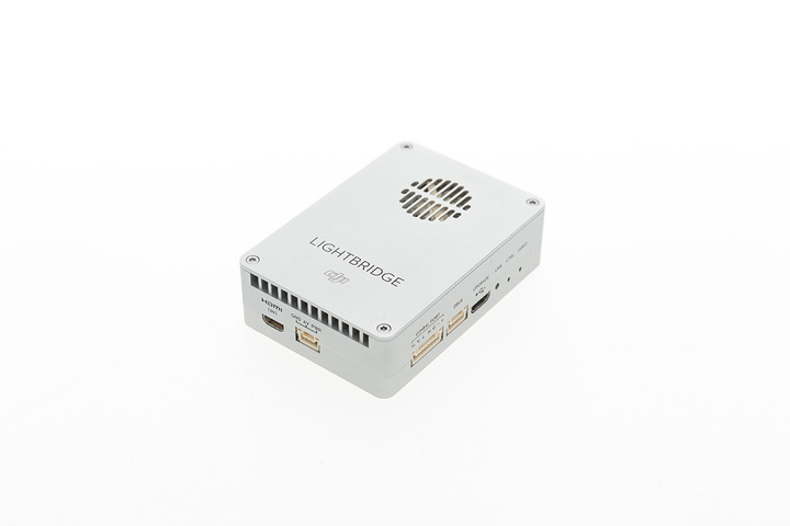

Does the DJI Lightbridge 2 Air System have the same working voltage as that of the DJI Lightbridge?
No, the DJI Lightbridge 2 air system has a working voltage of 3S while that of the DJI Lightbridge is 3S~6S. Please make sure the voltage is set to 3S when the DJI Lightbridge 2 with the cable from the DJI Lightbridge.
Is the AV input port on the DJI Lightbridge 2 Air System in any way different from that of the DJI Lightbridge?
The AV input port of DJI Lightbridge 2 air system is also used for power supply, which is different from the previous generation. Make sure to avoid short circuiting this port during installation and use.

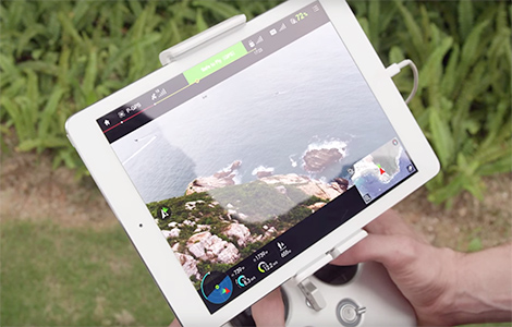

What is the largest tablet that will fit in the Ground System’s mobile device mount?
The mount can hold an iPad Air or other similar-sized tablet. Tablets should be no more than 170mm wide.
Which app should be used with the DJI Lightbridge 2?
The latest version of the DJI GO app for iOS and Android should be used with the DJI Lightbridge 2.

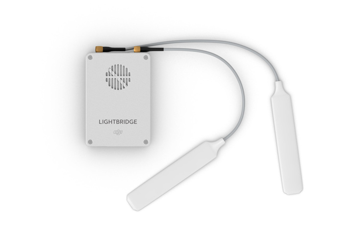

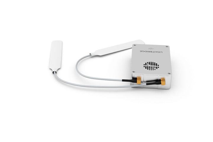

How do I install the Air System antenna when using Antenna Extension Cables?
First, mount the Antenna Extension Cables to the Air System. They will make a clicking sound when successfully installed. Then, connect the Antenna Extension Cables to the antenna of the Air System and install the Antenna Mounts to the landing gear of the aircraft. For optimal signal performance, adjust the Antenna Mounts to make sure that they are perpendicular to the ground when the landing gear is retracted. Use cable ties to fix the Antenna Extension Cables.

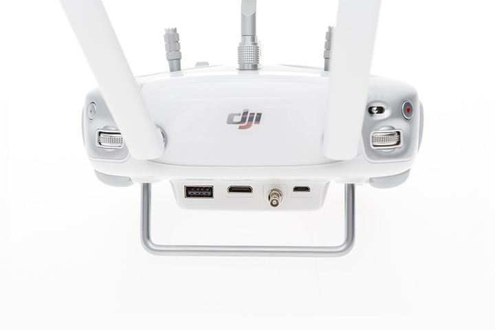

Can I use the USB, HDMI and SDI output ports on the Ground System at the same time?
You can either use USB and HDMI output or USB and SDI output simultaneously. The HDMI and SDI output ports cannot be used at the same time. You can choose the output port configuration in the DJI GO app. The default output port is HDMI.
